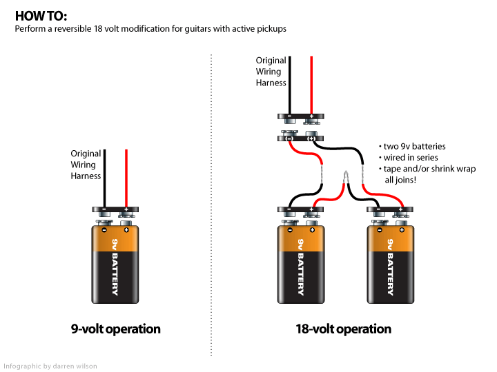

Post by screamingdaisy »
GuitarBilly wrote:It sounds great man. How do you do the 27v mod? I know it's 3 batteries, but are they in parallel, meaning connect all 3 blacks and and all reds? Or is it series?
To be fair, I like the way stock EMGs sound, precisely because of the headroom compression they have. I think it's a cool sound and it's a bonafide classic tone by now.
But this does sound a lot more open and passive-like, which is cool.
It's funny that the best way to make these pickups sound like passive pickups is to make them more active with additional voltage :lol:
I like this method since it avoids cutting the original harness. I’ve gone back and forth over the years, currently with 9v because I want to drive the preamp (I’m on bass, so I have the pups and preamp onboard).
