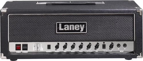

So question... I have seen some GH50L pictures that have the large can filter capacitors [blue dual section] that are seen in older Marshall heads, and I have seen other images that don't have the large can filters? I have also noticed that there are different logos/handles for these amps.
Can anyone tell me if there is a difference in the amps with different head shells?
I just ordered one from the used gear section on Guitar Center's website that looks like this:
as opposed to ones that look like these:
I really hope that mine has the dual section filter caps like my JCM900...

colejustesen wrote:So question... I have seen some GH50L pictures that have the large can filter capacitors [blue dual section] that are seen in older Marshall heads, and I have seen other images that don't have the large can filters? I have also noticed that there are different logos/handles for these amps.
Cole
The newer one (recessed handles) will probably use board mounted snap in caps rather than cap cans. They are harder to replace ( although not a big deal) but snap in caps are usually way better spec'd than can types.

Zozobra wrote:The newer one (recessed handles) will probably use board mounted snap in caps rather than cap cans. They are harder to replace ( although not a big deal) but snap in caps are usually way better spec'd than can types.
May I ask what you mean by better spec'd?
